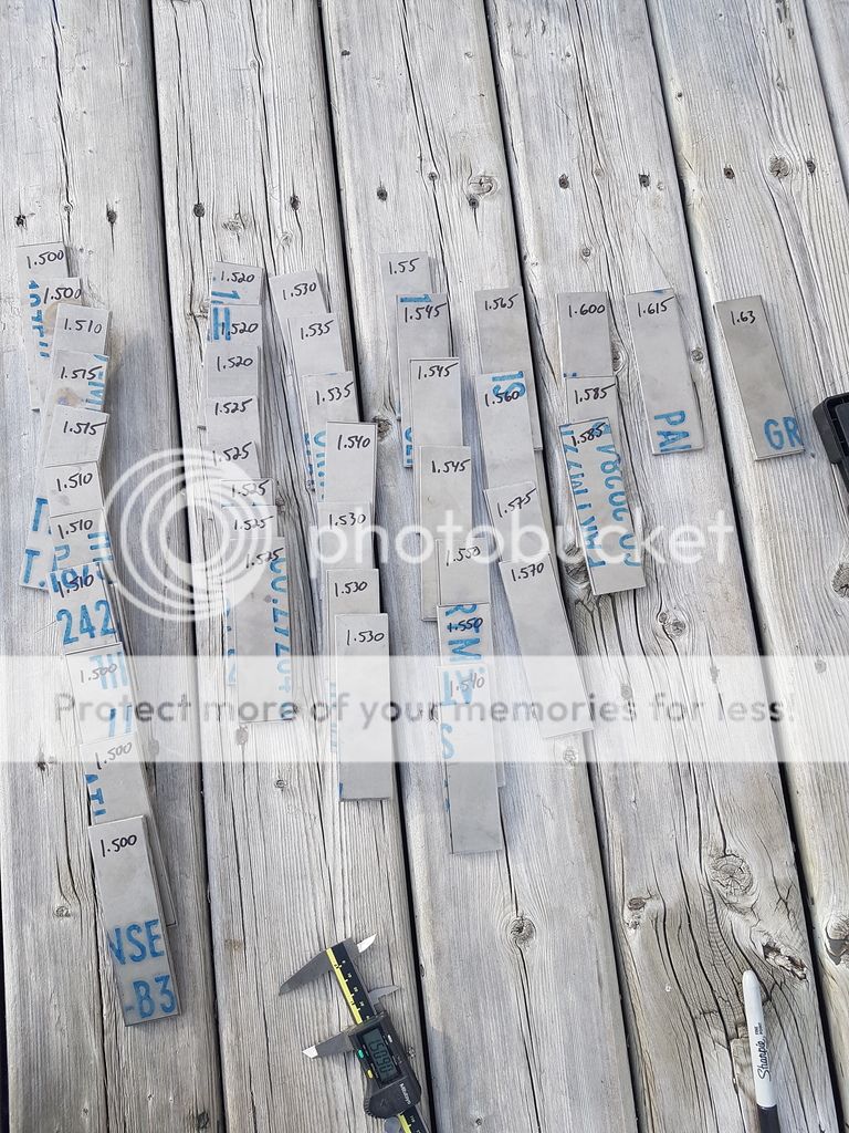

    I have access to an enormous shear. This will save on tooling as titanium eats even the best coated carbides.
    [​IMG]
    [​IMG]
    [​IMG]
    A couple more weeks and we should have more pictures to share if you guys want updates

    Looks good. I'm guessing these are 3/16" thick and the measurements are the width of Ti material. Then shape these into 110 frames. Cutting slots for handle slabs and drilling the holes for screws. Maybe 4 holes if you glue the handle slabs in? All with a CNC cutter. This will be some major advancements forward for you.Good times ahead. DM
  11. JAGcustomknives
    JAGcustomknives Making Knives Again Moderator Knifemaker / Craftsman / Service Provider
    Aug 31, 2010
    Thank you David. You are correct. 3/16" bolsters are slightly smaller than current factory production.
    Handle slabs can be glued or bolted. They are sorted by maximum width for easier machining/squaring of the sheared edges prior to clamping.
