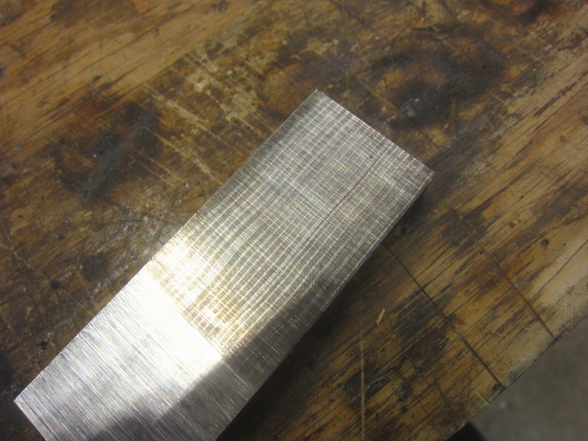

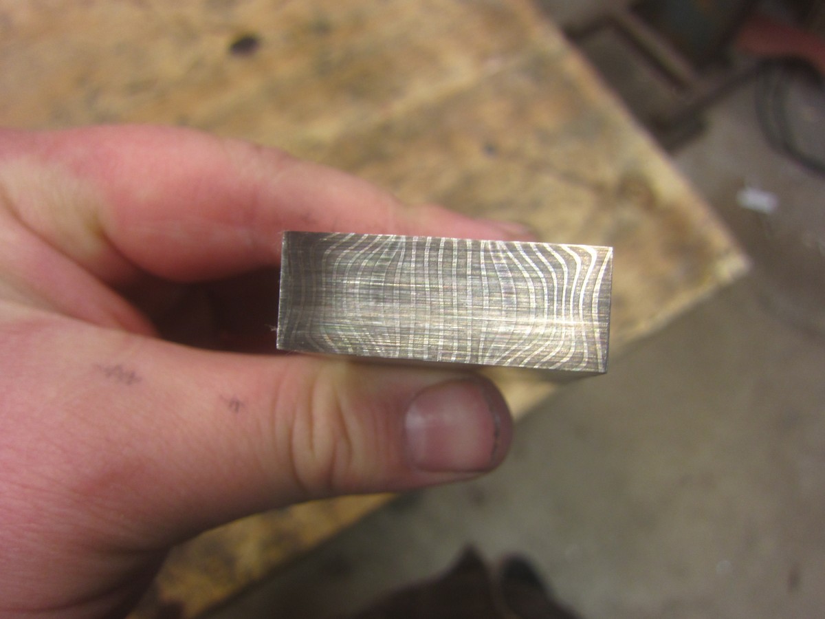

    I didn't get pictures of the first few steps, but I'm sure most of us have seen it before. I started with a billet of 15 layers, then triple stacked it, adding a couple of layers of 15n20 between the pieces for a total of 47 layers.
    Then I rotated it 90 degrees and drew it out to 16" long. Then cut it into fourths. I ground the pieces clean and etched so you can see the layers:
    [​IMG]
